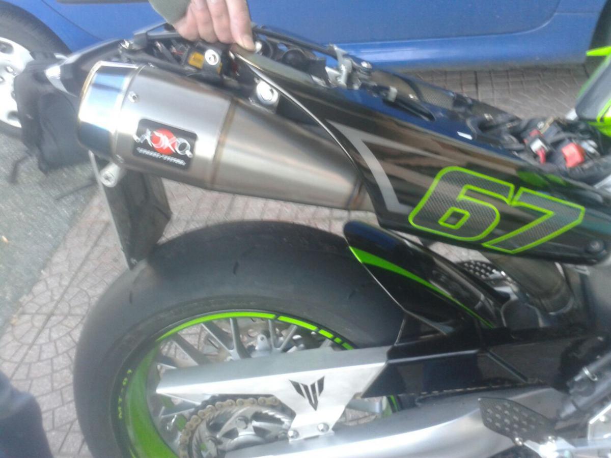

Here you can see it with the carbon heat shields:
As I said before, too much gap!
It would be enough to move slightly to the outside to get well in the frame of the cover terminals ... nice work !!
Working much likeable ... like I said it would be enough to move a little more to the outside and carbon frames are perfect!!Bravo!! ;)

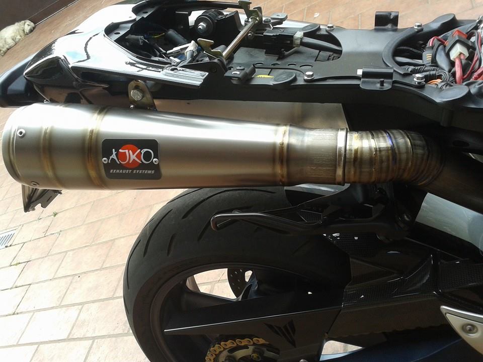

post-2747-0-05066400-1429130501_thumb.jpg post-2747-0-00750800-1429130513_thumb.jpg post-2747-0-45923800-1429130525_thumb.jpg

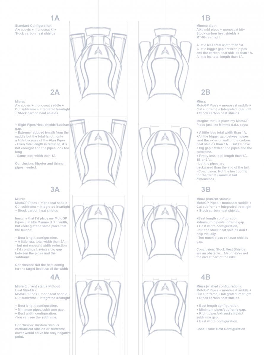

 Hi mate,
 Again I disagree with the solution that you propose... Maybe it was pretty difficult to explain correctly with words... so I´ve done a small study with several fast sketches of the top view of the different tail configurations arguing why it wouldn´t work in my bike (in my opinion) and why I placed my MotoGP exhausts in the place that I did.
 Here you have folks:
Anyway, I´m completely thankful to have your opinions and listen different points of view mates... I hope you continue in order to improve!
